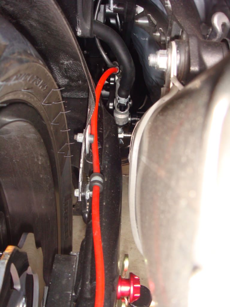

I have the Bestem CF Hugger also, just call them up and ask them to send you a bracket for the right side. Its just a simple bracket that works fine. I have had it mounted on my bike for a year now. Just make sure to use nylock nuts so they do come loose. I will try to snap a pic and post it.

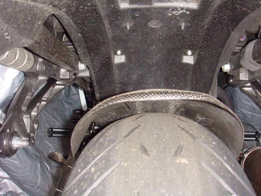

Yes its not perfectly straight but if you don't get down and stare at it to me its really not noticable. Heres some pics I just took and I think it still looks good.
