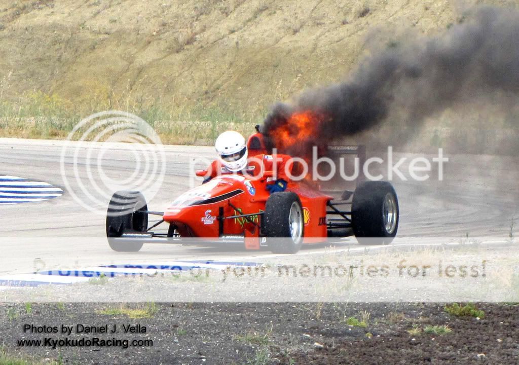

Last weekend I was circuit racing with my ZX14 powered single seater race car and totally cooked the engine and it ended up catching fire. This happened only 2 laps before the finish whilst I was leading.

johnbull
Posts: 308
posted July 02, 2009 11:22 AM
Yep thats what happens when you get oil thrown everywhere!!!!! I think thats definately the quickest I've ever gotten out of the car!!!!
John Bul Racing. Malta.
