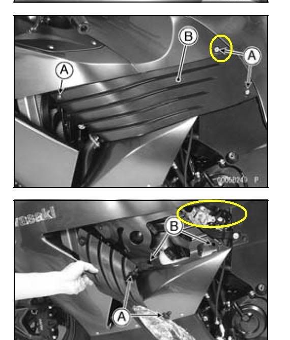

dont know if this is old info or not...
was chatting with a friend who had the following experience...
the bodywork well nuts that mount into the sides of the airbox on his zx14went missing, they were replaced ...
now here's what happened. TUrns out previous owner had stripped the brass threads in the nissing wellnuts, brass etc inside airbox... when the wellnuts were replaced this sealed the airbox and sucked (you guessed it) brass shavings etc into the engine... toasted the engine...
so beware and check to make sure these wellnuts dont go missing - if they do, STOP and inspect your airbox!!!

Where the hell are these nuts, I removed the all the body work to do exhaust and powercommander. Could someone post a pic?

Much more on this here: http://www.zx14ninja.com/phpbb2/viewtopic.php?t=9502
epd345
Posts: 1394
posted December 21, 2008 05:32 PM
Thanks for the PICS

It doesn't take much torque to tear a wellnut. I've done it, more than once. That has got to be the stupidest design flaws ever. If the brass nut tore and fell off down the throat of a throttle body, disaster.

I did a "rant" on these awhile ago. Not much you can do to change em.
Just check them over real good anytime you remove the plastics !

Hey....that's my old pic :-) .........when I repainted.
I was considering riveting in a nutplate....esp since I don't need sealing.
