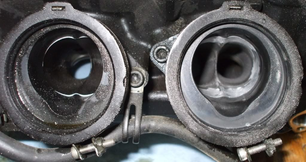

hey thanks for huge support guys,
I will leave OEM cams and just change gasket and port head.
Does zx12r have metal gasket? I bought light moded my bike
and I can see there is metal gasket.
I will post pic how it look like.
If this not tuning gasket how thin should I buy?
Scott is it diffucilt to port head by yourself?
I polish some rims and frames so I think maybe I could handle this.

I would suggest milling the head to raise compression rather than use a thinner head gasket. better squish, and I believe the 3 layer MLS gaskets seal better. use oem or cometic. you should adjust cam timing with either method IMO.
if you are asking if its hard to do, you probly shouldnt touch it unless you do a very very light job. you can remove too much material and ruin the head very easily.

Again it's very unlikely that any "porting" you have done will be beneficial. The stock head is VERY good and just right for the stock size engine. I think others will agree when I tell you NOT to do that. What WiLL help, in addition to the head mill that Scott suggests, is a very high quality multi-angle valve seat grind. (Don't grind the valves- it removes the hard facing).You can also match the rubber manifolds to the port and VERY LIGHTLY clean the port without changing the shape. You can also LIGHTLY smooth the transition of the seat to the aluminum, but that's all.
I respect you for listening to us- it is a hard thing to accept that the stock engine is that good, but we've been working on these for years and have thoroughly researched this engine.
