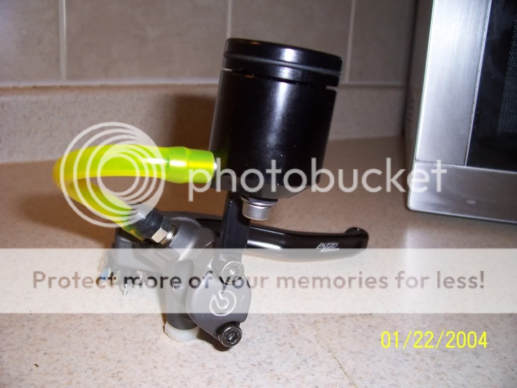

yep it works,, its what i run... Brembo MC with Motul fluid,, Goodridge Braided lines and a Pazzo Shorty lever to match the other side made by Brembo.. HH EBC pads,, Zx14 Calipers and 04 Radial Forks and Rotors.. thats all you need!
forgot to mention this is a Brembo 19X20 MC and this setup is so good i wouldnt change a thing!
